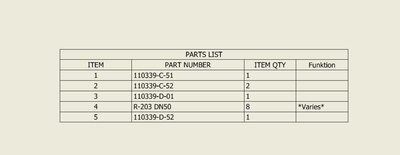

I a part with several instances that i want to give a personal value and disclose it on BOM/Part list. It would also be nice to use same parameter to Ballons and surface texture etc, should be possible?
Anyway i can't get it to work.
I have made my own parameter in Instance Properties.
In the BOM list,
I want each individual value for the same party to be reported separately.
I would like to have something similar in the part list aswell, but of some reason it can't find my parts value
It feels like it should be possible to use the same parameter?
