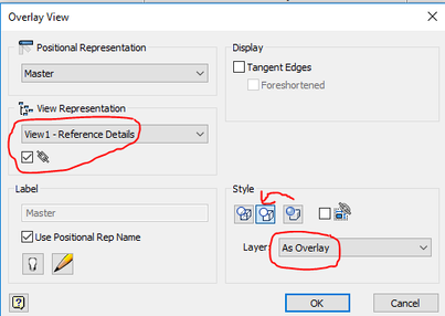

catot
@malcolm_smith @torbjorn_heglum1
I think I have a solution which will help you achieve what you want. See picture below.
If this is of interest, please let me know, and I'll post the workflow required. This is quite easy to set up and maintain.

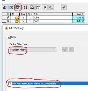

Message 14 of 30
catot
Here's the workflow.
Create View Representations in the GA-Assembly (top-level). For every layout, create 1 view where only the parts/assemblies you want to show as active are visible, and another view where only the parts/assemblies you want to have as reference are visible. If your assembly doesn't have a Positional Representation, just create one and switch back to master. (explained why later)
On the Drawing, the main view for your layout, should have the "active-view" enabled.
Then create an Overlay View on top of it (that command is only available if there are minimum 2 Positions in the assembly, hence why creating it earlier). Use the "reference-view", and layer as Overlay. (you can even leave the Position at Master)
Filter your drawing partlist using the "active-view" you created.
Repeat as many times as required.
