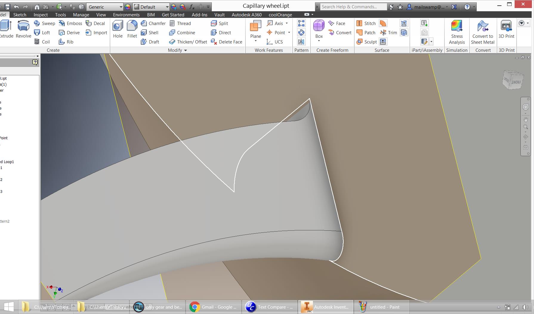

Did I find a bug?
Try to fillet both sides of this part if you want to find out.
This skinny trunk thing meets the wheel. This is where I want to create a fillet around all
Model included. -- Inventor 2016.

WHolzwarth
It's tricky.
Feature pattern didn't work well, I had to use solid pattern  and re-combine instead.
Splitting to only 1/32 of the full circumference and pattern this would work,too.
2016 file attached.

Hi mailswamp,
Using my build of Inventor 2016 I didn't see a failure when I deleted your Fillet6 and created it again, you might be short on a few updates.
Can you install the service pack and latest update from here and then try the fillet from scratch?

mailswamp
Still looks like a bug that requires workarounds.

Did you try updating your version of Inventor with the service packs and updates and then attempting the fillet?
