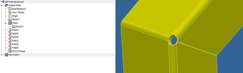

Coming across some old parts designed by other people in the company and they have geometry that is self intersecting.
The problem with this is that it causes "Interference Analysis" to fail on an assembly that contains these parts.
The part doesn't even show any issues with these parts, so I'm at a loss of how to detect it.
Does anyone have a method that can tell me if the part is self-intersecting?
(I'm assuming at this point I might have to use the API to access some object properties, but not even sure how I would do that, so any further help would definitely be appreciated!")
Attached is an example of the file, as well as a picture. (see flange joint pointing to the bottom right of the picture)

Issue is located in the old part.
I've made some changes by thicken operations (2017 IPT)

Thanks for the response Walter.
That definitely shows an easier method for fixing the parts than what I was doing before (editing sketch/cutting/re-constraining/extending lines, etc).
However, what I am actually looking for is some method or some procedure that consistent fails or acts as an identifier for self-intersecting parts so that I can use it in a VBA macro and establish a list of all parts within our file system that are self intersecting.
Some things I've tried:
1) Inserting the part and a dummy part in an assembly and running interference analysis
        - This doesn't consistently fail, so cannot be used as a good metric.
2) Checking volume vs mass to see if there are inconsistencies because of the overlapping material
        - Inventor appears to calculate the volume/mass based on the final composite solid, rather than using individual features,
