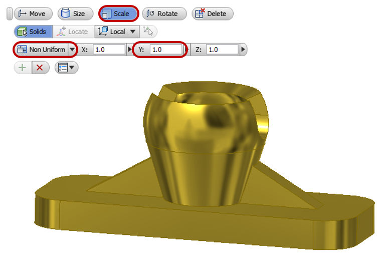

if you're trying to scale items ..you can do that 2 ways now
Direct Edit
Derived

I'm trying to scale a solid object along the Y axis. Is there a more up-to-date resource? The SDK usertools are all still present, they simply don't do anything when installed.
mdavis22569
look at my last posted I updated it
In 2016 and up it's in 2 different commands
and you can do what axis you want, in the direct edit way

Hi!
Just use direct tool with non uniform scale
CCarreiras
Ah, I see now! Thank you!
