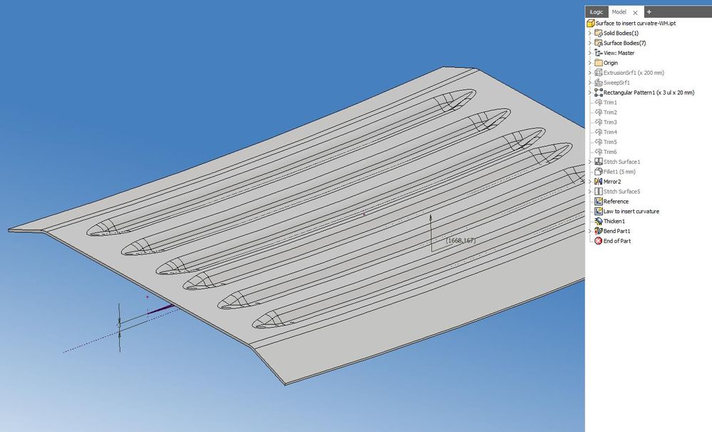

Here is a sample file to what I need to do.
There is a Sketch with name "Reference" that is like the surface in it's standard. And there is also a sketch "Law to insert curvature", That represents the need curvature of this surface. So this surface will be like the existing one, but with the curvature given by sketch.

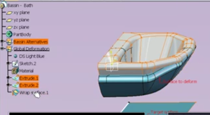

S_May
Hi @Anonymous
How many years experience they have with Inventor?
I've worked with catia myself, but inventor can do that too.
Just changing the curvature quite simply over everything is not the inventor's strength.
Please show a sketch with Dimension
Sorry my english Smiley Embarassed
2.png2017-07-18 07_33_07-catia wrap surface deformation - YouTube - Internet Explorer.png
Message 7 of 11
Well I only have a few minutes behind Inventor. At the moment I still work with CATIA. This work, is quite easy to do in CATIA, but with the proper surface license.

WHolzwarth
You can use the Bend Part feature for that task.
Later: Oh, I've seen. It's been already mentioned by Johnson.
2018 IPT in attachment

Ok.
I will analyse that, and see if the final result is what I expect. Can you send me the modified part?
Message 10 of 11
WHolzwarth
File is attached in my previous posting.
