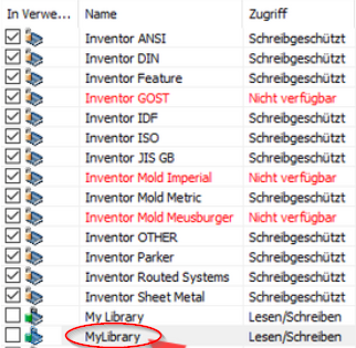

Thanks for your support and now for all other users:
The error was in the display name of the .idcl file. It was different to the file name.
It was loaded correctly in library configuration, but because it was called "MyLibrary", I ignored it.
Resume: If something like this occurs, first check the properties.

...I allowed myself to post a small portion of the "problem" without disclosing sensitive data from Karl.
The library in the red circle has an idcl filename that is completely different, and we were both searching like stupids (at least I was) for something that was under our nose 🤣
