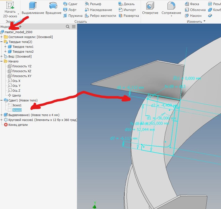

Message 8 of 13
89198826955
So the best solution would be to abandon the frame generator and create a multi-body part?
Create a frame profile --- autocad blocks -- or draw it yourself?
