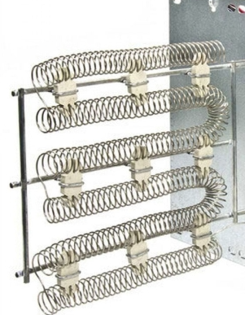

I have a similar thing I am trying to achieve but am struggling. I want to produce a helical sweep along the path below. This is a heater element coil. I found a Youtube that suggested creating a twisted surface and then use the edge of the surface as the path., but this was done on a circle. When I try to create the twisted surface using the below path, I get the error "the given sweep patch is not tangent continuous. To use the twist option, provide a smooth path". I have tried adding fillets between the straight lines but then get the error "The attempted operation did not produce a meaningful result". Any help would be greatly appreciated. I have added the file below. The coil size (for reference) is 6mm centre diameter and 1mm diameter wire. The pitch is not massively important, but I would like to get close to 2mm.

dan_inv09
if the radius of your fillets is smaller than the radius of your coil (plus the radius of the wire if you get that far) then your coil can self intersect and Inventor won't do it.
I'm thinking that the straight bits run between some supports and the wire probably won't be coiled right there anyway. This picture is probably the opposite of what I'm trying to say but it's the closest picture I could find quickly:
maybe make just your straight segments coiled and then run little bit of straight wire between them
