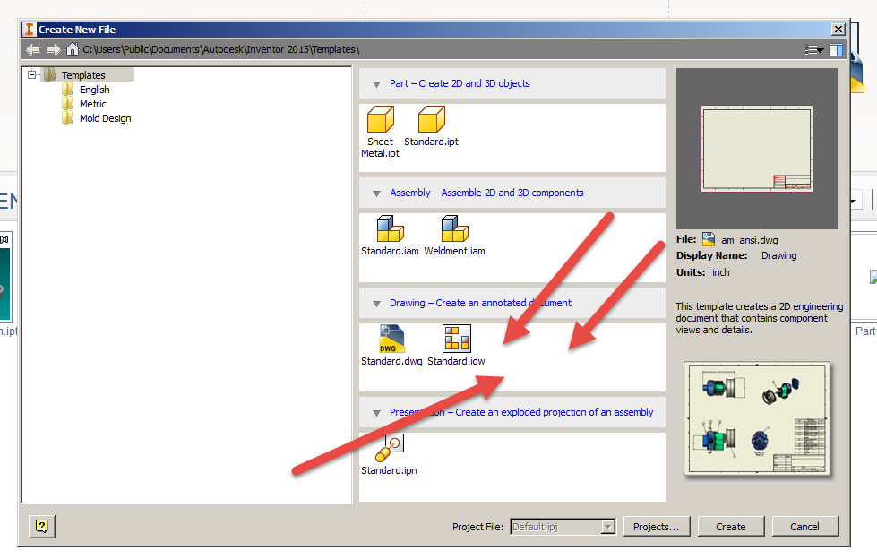

You can see this template is saying “Drawing - Create an annotated document”. I wish to know whether you can insert your own template. If so please show me the procedure.

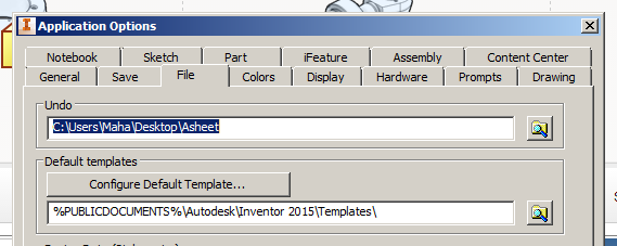

My template is in Desktop and file name Asheet. I gave following file path but it is not saved in Create New File window of the Inventor.
C:\Users\Maha\Desktop\Asheet

Thats the "Undo" location.. (read the field titles)
Look at the field below that.. Your templates are stored in your "documents/autodesk/inventor 2015/templates" folder

What I want to know is while retaining the standard templates whether it is possible to add my own drawing templates.

What I want to know is while retaining the standard templates whether it is possible to add my own drawing template which is on the desktop.
