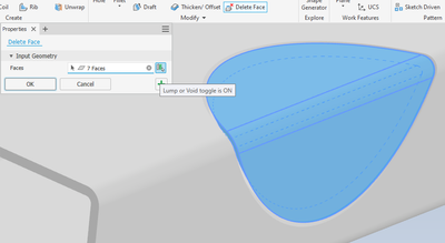

johnsonshiue
Hi! Slightly different approach than Gabriel's solution. I would not use Boundary Patch in this case. The base face is a cylinder. There is no need to recreate it. Just restore it. Use Delete Face -> check Heal option -> select the inner faces. The cylindrical faces from the pipe will be recovered.
Many thanks!
