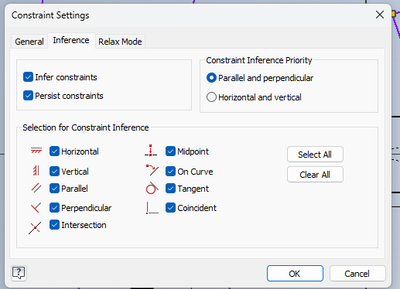

Inventor auto creates some constraints depending on your settings, and I suspect that's what you're encountering.
You can change those settings as shown below
Edit: If this doesn't solve your problem, maybe you can attach a part exhibiting the behaviour so I can investigate?

These settings only apply when you're drawing, so disabling them afterwards changes nothing - So I'd only expect a different result if you redrew
