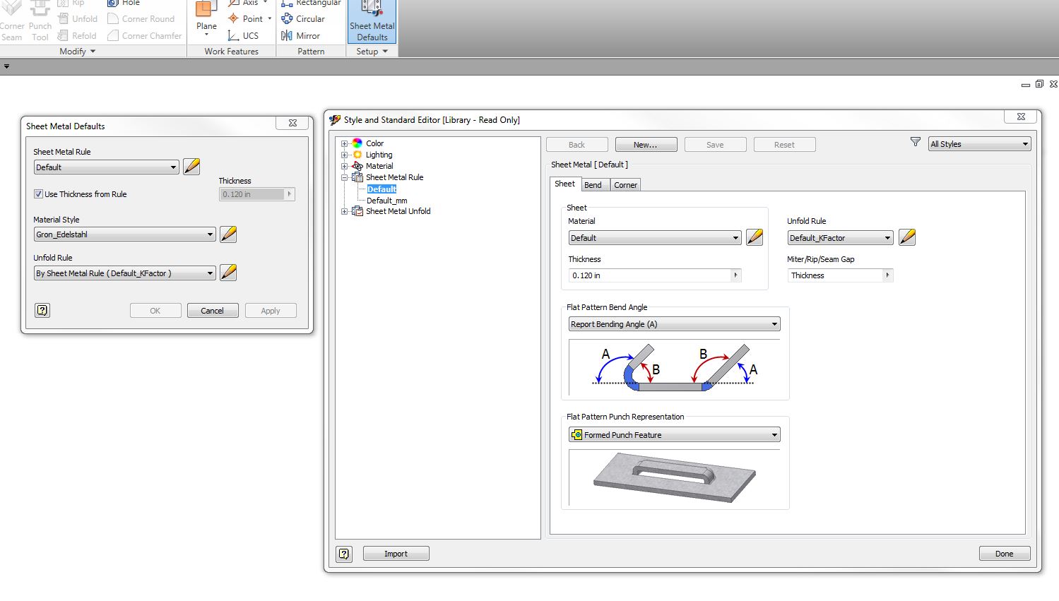

mdavis22569
in reply to: Anonymous
it's controlled by under your sheet metal default
your other pop up ... and k-factors or bend comp.
You just need to know where to look
added: in case someone says where ...
