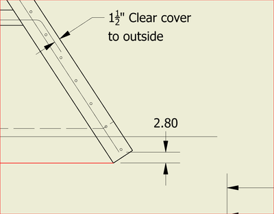

This is the pre-highlighting. Which is with the mouse over the line but not selected.
This is the selected/highlighted line.
Here is where the real problem comes in. While sketching lines, the lines are already green and the selected line is almost indistinguishable from the non selected lines (to me).
See the line between the two 6.00" constraints is selected?
