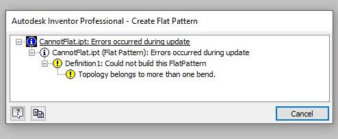

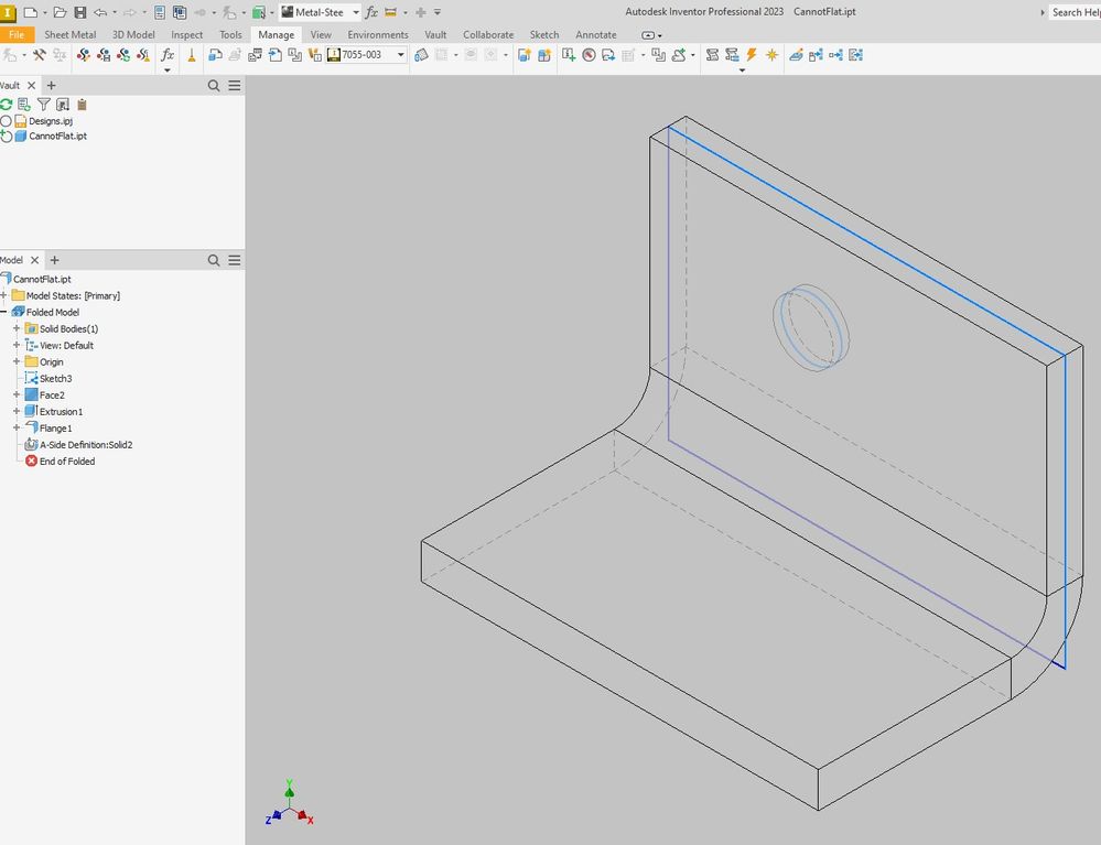

Can't get this to flatten.
I'm "cheating" to show something (the hidden circle cut) on drawing and found out it can't flatten.

Extrude 1 causes the problem. Does this cutout have to be inside?
I think this way the program loses the material thickness, which is necessary.

Frederick_Law
It doesn't matter how "thick" the cut is, it'll fail as long as it doesn't cut through the part.
If that extrude cut through either side, it works.
Yes, I do want that circle inside.
And yes, normally it won't be modeled this way.

This is a limitation in Inventor Sheet Metal. The interior cutout introduces inconsistent thickness. As a result, the Flat Pattern rejects such body. There is a workaround, kind of hack, however. Here is what you want to do.
1) Reorder Flange1 above Extrusion1.
2) Move EOP below Flange1.
3) Unfold -> pick vertical face as the reference plane -> pick the bend.
4) Move EOP to the bottom.
5) Refold.
6) Create a new Model State with the Refold feature suppressed.
7) Document the new Model State as the Flat Pattern.
Many thanks!

Alexander_Chernikov
One more tip
If include hole in "Face2" or do it with "Hole" command the part will unfolded

Frederick_Law
@johnsonshiue wrote:
Hi Frederick,
5) Refold.
Many thanks!
It will be ModelState with different size.  So can't use this trick.
Message 8 of 9
Frederick_Law
@Alexander_Chernikov wrote:
One more tip
(see attached file)
The goal is "hide" the "hole" inside the part.
As long as it cut through one face, it'll work.
As long as it's a "cavity" inside the part, it failed.
Message 9 of 9
Frederick_Law
Since this is a limitation, I'll try other way to get what I want.
