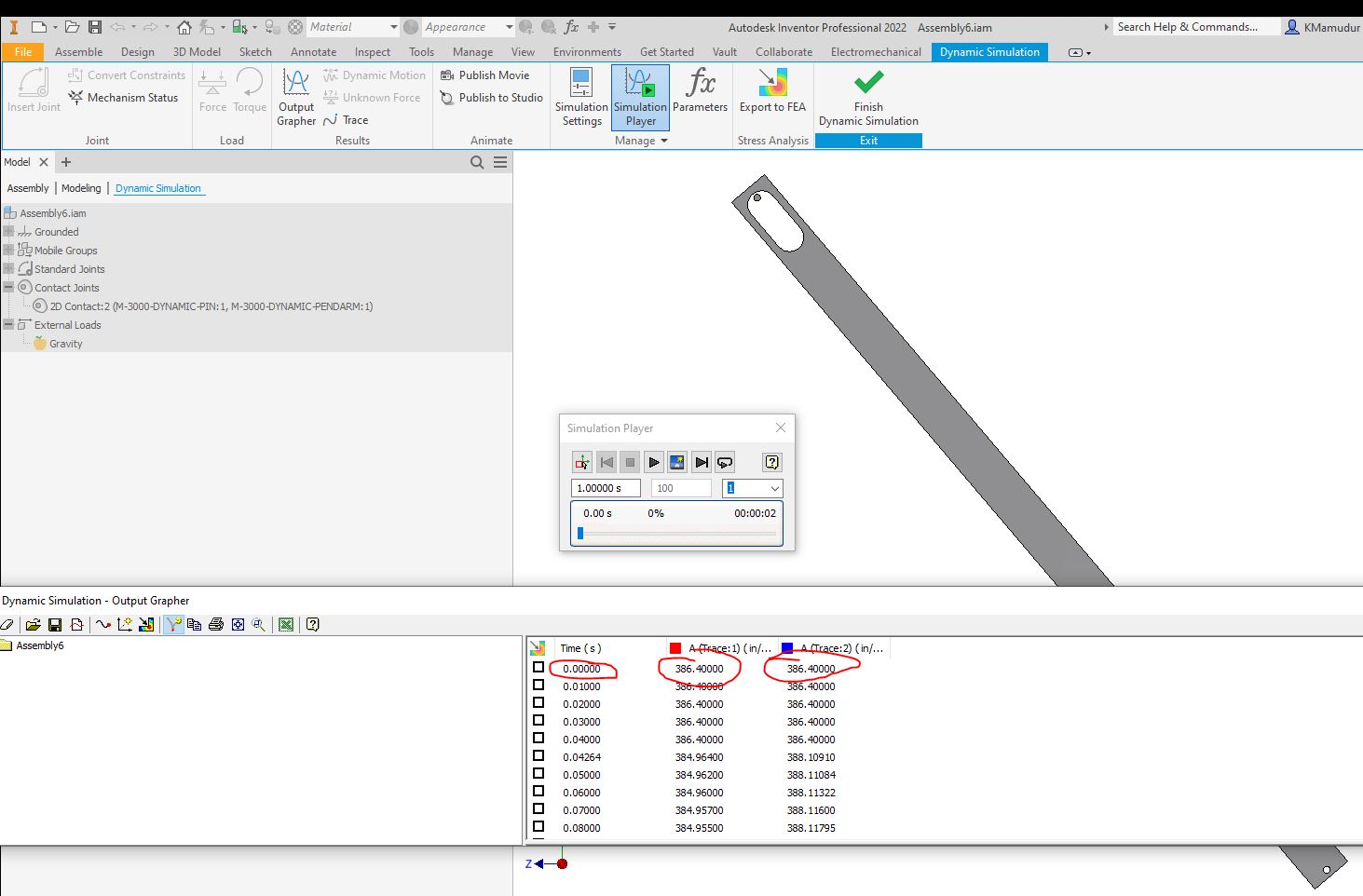

Hello there,
I modeled a simple arm hinged at top acting like a pendulum. I am trying to release drop the pendulum from an angle. Once I run the simulation and check the trace plots of acceleration @ time t=0 I see different acceleration numbers on different portions of the arm. I was expecting to see a CONSTANT 386.4 in/s^2 acceleration as the body is at rest at time =0. Whereas I see different g numbers at different points of the arm.
I have attached the model and also a screenshot showing different acceleration numbers at time t=0
Can you please explain what is happening?

KMamudur
Hello Steve,
The accelerations reported are both resultant accelerations. Not any component. Please see picture attached.
At time =0 when the pendulum is at rest shouldn't both the accelerations be =1g?

KMamudur
Thank you for a quick response.
Really a part that is in rest will have different accelerations along its shape?? See image below when I made my contact manually in dynamic simulation instead of importing contact from Inventor 3D model. I see same accelerations at time t-0 as I was expecting. 100% same geometry, like I said instead mating the arm with the pin in Inventor environment, I came into dynamic simulation and created my contact between the od of the pin and Id of the slot in the arm. NO OTHER SETTINGS WERE CHANGED
Can you explain this please? I can send you this modified assembly file again if need be.
Please see picture attached below.

KMamudur
So, you are saying a body at rest (Pendulum arm in this case) will experience different accelerations along at different locations on it. It is like a man standing still on earth in a bent configurations and his head is seeing x times more accelerations than his arms? I cannot understand that.
Even if I assume it as true for a moment, why did my 3rd simulations on the same arm yield same accelerations at every location of the arm while the arm is at rest?? How do you explain that? See the picture of the 3rd run attached again with this post.

KMamudur
Hello there,
@ t =0 the mass is at rest, or just starting to fall down. It starts to fall free and make contact with the fixed/grounded pin and then starts to swing/pivot about the pin as the pin is grounded and the MPC equations kick in. at time =0.000001~0 seconds I expect the freely falling arm to feel 1g load and not more. Also every point on the freely falling arm (before it touches the grounded pin) should see 1g load and not different value. Can you please open the assemblies that I sent and see it for yourself? I am attaching a picture showing 2 scenarios where inventor predicts different g's at different points on the arm @ t=0s and same g's at different points on the arm @ t=0s. I am also showing you the position at t=0s to avoid any confusion if you have not opened the model/.iam file.

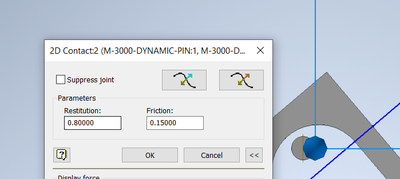

Message 13 of 18
KMamudur
Please see both models attached. Let me know if @ time =0 the arms have to experience same or different accelerations across different locations on the arm. After it is in motion, different points will see different accelerations etc. But when they just start do you think they should be different? In Assy6 I am not putting constraints in Inventor, I am adding a joint in dynamic simulation instead and that gives me same accelerations at t=0.

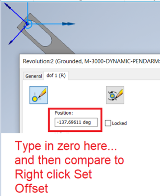

JDMather
In Assembly4a
you already have an imposed position change...
No Friction on the Revolution Joint.
Will only rotate about axis - no other motion involved.
_____________________________________
In 2D Contact Joint - Restitution (bounce) and Friction.
Translation in plane as well as rotational motion..
and imposed Position change in all three...  (I should have screen capture at the Rotationl DoF, but you get the idea)
These are not even close to equivalent cases.

Message 15 of 18
KMamudur
Hello there,
Thanks for looking into it. My intent of this exercise is to see if the initial accelerations are being reported correctly. Even with those modelling differences between Assembly4 and Assembly6 shouldn't the initial accelerations not be the same ? My key question is this: "The arm is at under the influence of gravity= 1g at t=0, doesn't that mean every point on the arm at t=0 needs to read 386.4 in/s^2 till is starts accelerating further?"
Position (-~137.96 deg) shown above is correct as I intent to release/leave the arm starting from that position. I don't think friction input will affect the accelerations at time t=0s, correct me if I am wrong. Yes, in Assembly 6 it will pivot only about an axis, but again this should not affect the initial accelerations to which the arm is subjected to.
Can you tell me what I setting I need to change in Assembly4 to have it report 1g accelerations at t=0?
