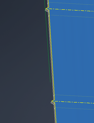

Message 22 of 37
chrisw01a
Curtis,
I have run into a problem on this.  See attached part and note that 2 of the holes are out in the middle of the part now.
When changing geometry on some parts, the points are losing their association with the other geometry.
This was happening on a normal rectangular part with 2 bends in it as well FYI.
Any clue what might cause this?
Thank you.
Chris

Message 36 of 37
hiendc587
bends.pngMaybe the file above doesn't run the rule. I fixed it!
Message 37 of 37
johnsonshiue
Hi! Many thanks for sharing the file! Now I understand it better. Indeed, Inventor does not have such corner relief on the folded body. You do need to "hack" it in the flat pattern.
Thanks again!
