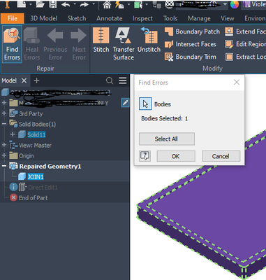

I do think it has to do with the imported parts. I've sent this part in the attachment.
The feature "Repair Bodies" does not show in the imported parts. The feature tree looks something like this:
Is there a method to fix this part? or do you suspect that the method of import is wrong?

Hi! Many thanks for sharing the ipt file! This has something to do with the fact that the ipt file was a substitute part for an assembly. When a part is designated as such, its mass prop will be totally driven by the assembly unless the substitute feature is deleted. Here are the steps to restore the mass prop.
1) Go to 3D Model tab -> Modify -> expand the panel -> Copy Object -> window-select the bodies -> output = Repair Environment.
2) Delete the Derived Assembly node.
3) Edit the Repair Environment -> Find Errors -> select all bodies.
4) Heal Errors -> select all bodies. Exit Repair Environment.
5) Go to iProperties -> Physical -> clear out the overridden mass -> assign a material style -> Update.
The mass will be calculated normally.
Many thanks!
