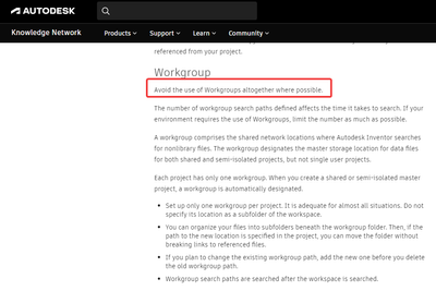

This topic is confusing to me, can somebody clarify please?
AutoDesk states following "Avoid the use of Workgroups altogether where possible."
My setup is following:
- I have network based STEP model
- I've created new project which has to be shared through the network for other colleagues.
- I'm using STEP model as reference model to build main assembly and parts.
My issues is that when colleagues are opening project file to work with the assembly, they always miss reference STEP file. We dont want to move STEP file to project location, its has to be remotely stored.
How extra network locations can be added to the project, if AD advises not to use workgroups? Libraries are not suitable, because they are not editable. What is the right workflow. Thanks

Hi! I am not sure I saw a statement from Autodesk saying Workgroup Search Path should be avoided. If yes, please let me know. Workgroup Search Path is quite similar to Library Path. The difference is that one can be edited but the other one isn't.

What we want to achieve is at the final stage break link to STEP file and have all its parts converted to IV files.
STEP model is in development stage, so we are getting new revisions from 3rd party. STEP file does not need to be editable directly, but we might need to extract some components out of it as IV models. If we use libraries folders, then "break link" option is not working. So we have to use Workgroup, but that is not advised.

Hi John,
HERE you go. Thanks for looking
Also screen shot

Hi! Many thanks for sharing the link! The statement seems contradicting to my understanding. I need to double-check with the project team and confirm the behavior.
