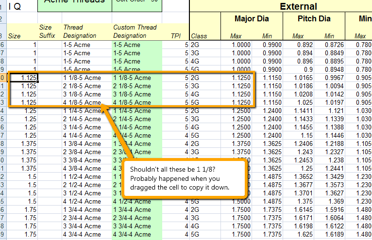

Need to put ACME Threads on a parts.  Searched here and found the attached ACME Threads.xls file.  I copy/pasted this into my Threads.xls.  Now when I try to use it, I get an error "Error in ACME thread family: Unit string in cell A1 is incorrect".  I have tried editing the cell, but I cant get this to work.
It appears that this spreadsheet was made for an older version of Inventor.  Could someone corrrect this so it will work with Inventor 2011.

Thank you for this.  I am sure it will help others as well.  I did see some errors in the xls file.  These errors are persistent from 1.125 to 4.00. I have attached a corrected file below.

You are right. All non-intergral sizes between 1.125 and 4 appear to have incorrect thread designtaion values. Thanks for spotting this.

Download the corrected file in post 4 of this thread to your downloads folder.
Then, make a copy of the file C:\Users\Public\Documents\Autodesk\Inventor 2015\Design Data\XLS\en-US\Thread.xls (just in case you need it later)
Open the original Thread.xls and also the Acme Threads.xls
In the Acme Threads.xls, right-click on the ACME Threads tab, select "Move or Copy".  In the "To Book" drop-down, choose "Thread.xls". Also in the "before Sheet" drop-down, choose the very last one..."move to end" and click OK.
Now you should have a new tab in the thread.xls.
Save and close this file.
Back in Inventor when you place a thread, you should now see this ACME Thread entry.
Post back if you are still having trouble.
