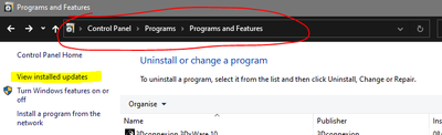

Message 16 of 32
SharkDesign
Go to control panel
Add remove
View installed updates
  Inventor Certified Professional
