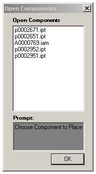

Ben-Cornelius
Hey could you provide the element builder for input listbox the restriction on the input listbox width with ilogic is driving us nutty. Thanks!
Owner2229
Hey, something like this?

Hey thanks for the speedy reply. Sorry no so I want to emulate the input list box from ilogic as below so the list would be a read only array list and the input would be the user picking one of the options. Thanks again!
