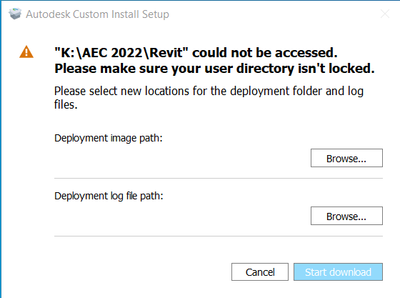

Using the new online deployment generator for Revit 2022. Deployment is created fine but when I use the batch file to install I get the dreaded yet ever present 1603 error. The log file tells me nothing except there was a fatal error during installation. What's next?

m_latz
Looks like the installer does not find the "J:" drive. Is this a local drive or a connected network drive ?
regards
Markus
Message 7 of 16
gbiallas
That's a network drive. I changed those locations back to the default C: drive in the modified deployment. I'm no longer getting the 1603 error but now the installation just sits in the preparation phase all day long.

2021-04-12T10:10:32.362 [Install Manager: 19160, single] [InstallManager DEBUG] [MsiHandler] [ MsiHandler::InstallUiHandler ] Returning as the error is informative Error 1327.Invalid Drive: J:\
2021-04-12T10:10:32.456 [Install Manager: 19160, single] [InstallManager INFO] [ InstallManager::HandleInstallFailure ] Failed to install Package (upi2: {AEEDBBA3-FB82-4CD4-893A-78E77BF95872} name: Revit 2022 ) Error Code: 1603 Exit Status: 2

I figured the J: drive was part of the problem so I removed that from the deployment. All drive locations are now the default. I'm not getting the 1603 error now but I'm also not getting anything installed. The "Preparing to Install" dialog box comes up and never does anything. I've left it running all day with no result.
Message 10 of 16
gbiallas
It's definitely a network drive access issue with the computer on which I was trying to install Revit. I got this error when I ran the deployment as an administrator:
