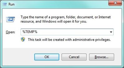

To generate a log file for the application please go to the Windows Start Menu > Run box (shortcut key Winkey+R) and typing%TEMP% into the box and clicking OK.
If you sort the files by date, you should be able to easily locate the Autodesk product installation .log file.  It will be named according to your product.  You can open this file in any text editor, such as Notepad and attach this file to your reply.
