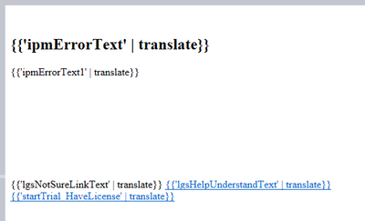

I installed Vault Pro Client 2023.  Right after the log-in screen comes up, I get the dialog below. After this, the only thing I can do is kill the process with windows task manager.  I have uninstalled/reinstalled twice but still get the same results.  I have also tried cleaning out the C:\temp folder before I reinstalled.
I have also tried to run as admin, but that did not help.
Any clues how to get this install and run.
Kirk
P.S. I do have Vault Pro Client 2022 installed and it runs great.  Just trying to test 2023 Vault Pro.

Inventor / ACAD / Vault Pro 2020 (and 2022) were working great before I installed Vault Pro 2023.  It all went downhill after that.  Now when I run Inventor 2020 and go to the "Manage License" page, I get this.  Again, in order to get past this, I have to use Windows TS and kill the process.

Inventor will launch with it un-plugged, but I still get the same blank dialog when I go to "Manage License".  Here is a list of recent Windows updates.  One of these might have broke things.  I don't access the "Manage License" very often, so not sure when it got into this shape.
I am assuming installing the Vault Pro 2023 did it though. I did install Inventor 2023 first, then Vault Pro 2023, so not real sure.

I just updated the ADSSO Component to V13.7.7 and the Autodesk Licensing Service to V13.0.0.8122.  Did not fix the issue.
I also ran across this page that discusses the blank image when accessing the license type.  Working thru that now.

The "blank" or White image when accessing the license type is also there in my Vault Pro 2020, Autocad 2020 and Inventor 2020.  Since Vault Pro is the easiest/quickest to uninstall/reinstall, I did that.  After the reinstall and reboot, the issue still persists.
The "Reset_login_win" from Autodesk did not help.

I just had my IT guy log-in with his windows account and it the "Manage License" works as expected.  He "rebuilt" my windows account and now when I log-in with my account and go to "Manage License", the problem still persists.
Not sure.  I will open a support case with AD.

I am still trying to get this resolved.  I tried to reset the license via your post #8 above.  Didn't change anything.
I found this article on "How to Change the License type for an already installed product".  I ran this CMD command and used the "-lm USER" option which should set it to a named user account.
"C:\Program Files (x86)\Common Files\Autodesk Shared\AdskLicensing\Current\helper\AdskLicensingInstHelper.exe" change -pk 569N1 -pv 2022.0.0.F -lm USER
Now when I start Vault Pro 2022, I get this.
I can change it back to a network account by using this command.
"C:\Program Files (x86)\Common Files\Autodesk Shared\AdskLicensing\Current\helper\AdskLicensingInstHelper.exe" change -pk 569N1 -pv 2022.0.0.F -lm NETWORK
Now when I start VP 2022, it starts normally, but its using the network license.
A few noteable things:
1. The Vault Pro asset is assigned to me (I am our account admin).
2. I have a support case for this (# 19884968), but we have not gotten very far with it.
3. The support tech had me run the "ADSK Licensing Support Tool".  It found two inaccessible URL's, but I ran it on another system that does not have this issue and found the same two inaccessible URL's.
4. I cannot create a "test" user account.  Our Windows accounts are managed by an outside IT company.
5. I did try logging into another workstation here using my Windows credentials.  When I start Vault Pro 2020 and try to "Manage License" I get the blank white dialog. as in message #3 above.
Kirk

 Tried to Reset the LGS (first deleted the license cache). Now when I start VP 2022, it goes straight to the "ipmErrorText" dialog as before, which should be where I select the license type.
