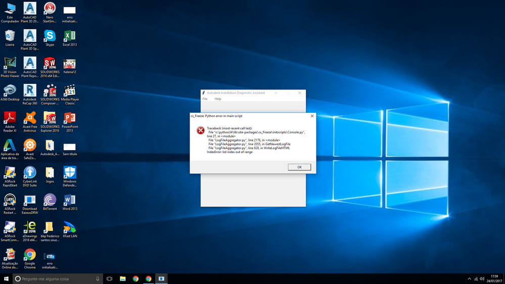

Thank you.
Message 19 of 25
Hi @natasha.l
I downloaded and installed AIDA. It does the scanning and gives a message, when the "ok" the message disappears and does no other action. Attached is a "print" of the message.erro initialization plant 3d_02.png
