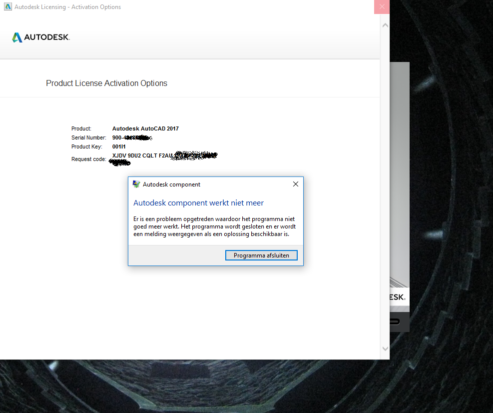

I have a AMD Radeon HD 6800, Windows10 Pro 64-bit (legal), Intel core i5-3570K.
The internet explorer fix didn't help ether.
The program works fine at a trail period now. It only crashes at the license check.
After i fill in the Serial number an the product key and push Next the program crashes.
Exact the same happens when i try to activate 3dsmax.
I made a screenclip movie so you can see what happens.
https://we.tl/wMoRFQZJsk
The only thing that i updated was the normal windows updates. No other software updates or patches have been made.
Hopefully you can help...

Message 44 of 74

Thanks for your reply, but this is also a know fix on the Autodesk website. It don't work. Special for you i tried again... But no... it still don't work.
So i tried a clean install again by remove all autodesk files, remove all autodesk registry files, used CC cleaner to clean all remaining autodesk files, and reinstall the latest online build.
And guess what? Same problem. I only see one screen more, with the request code, never able to read that before.
I tried an install at a win 7 system, no problem... Tried a win 10 system at my job, same crash!
So i think (just as "wallenengineering" says)  its a win 10 problem.
Time for some tech guy's to look at it!

Thanks for you reply! It suddenly works now!
finally...
