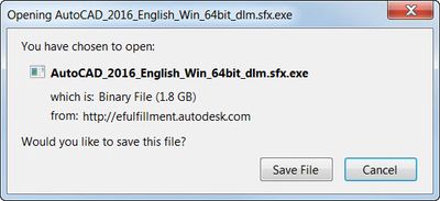

Once downloaded the file should look similar to this:
Downloaded File
If this information was helpful, please consider using the Accept Solution
