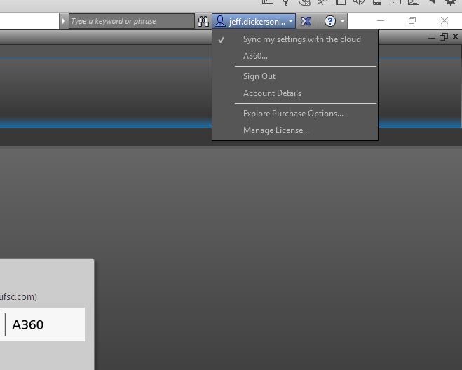

No worries.  I understood.  No I can not see in Explorer.  I can see in AutoCad 2017, meaning I am connected.  But have NO IDEA where the folder is. Screen Shot 2017-01-17 at 12.13.57 PM.png

BrettWright
ok thanks Jeff,
A few other thoughts here.
1. When you go to your system tray, do you see the A360 Desktop icon at all?
2. if you go to your control panel > install/uninstall page, is A360 Desktop listed there at all?
3. From within AutoCAD, from the upper right a360 dialog that you showed earlier, are you able to "sign out" then "sign in" again by chance? (have a file open when you do this)
Brett Wright
