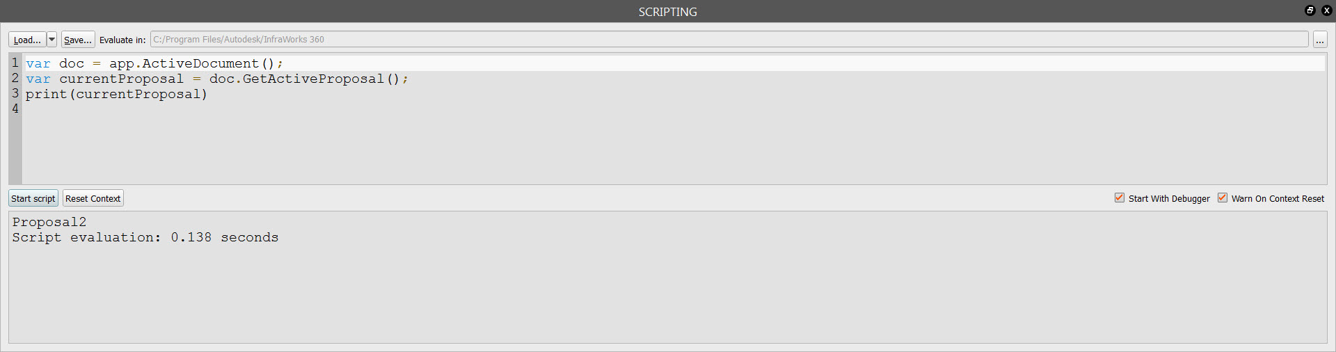

Here's what I see when I run your code (below). The script has executed the Get of ALL proposals.
But, if I do some tweaks, I can then print AllProposals. You can see that the console printed out the names of the 3 proposals in my model (master, proposal1, and Proposal2). Interestingly, it looks like Proposal2 is printed out first, which is coincedentally also the active proposal.
But if I change my JS a bit, I can instead print the name of the current, aka active proposal.
var doc = app.ActiveDocument();
var currentProposal = doc.GetActiveProposal();
I know this doesn't completely answer your questions, but hopefully this helps! (Sorry, I'm not a JS expert, just guesstimating some of these things).
