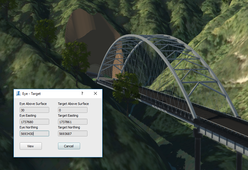

Glenn.Coppard
Nice Work!!
Now you can have a go at making a UI panel for the user to enter the eye/target co-ords.
I use something like this to create my bookmarks from/of specific view locations.
Image and video hosting by TinyPic
Take a look HERE for some 'how to' inspiration.

Glenn.Coppard
[edit]Image from post 5 re-hosted[/edit]
Specific Coordinate UISpecific Coordinate UI
