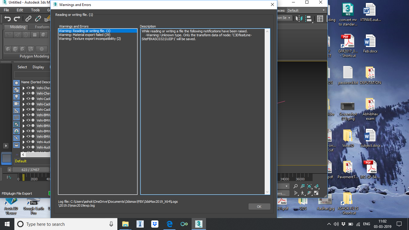

hi,
I am getting the warning message while exporting the animation as DAE . Pls help me.
I am new to this and in the learning process.
Screen shot attached .
Regards
