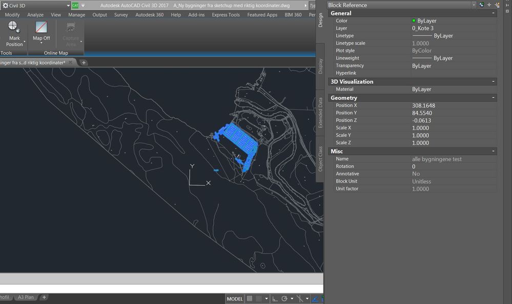

Thanks for the suggestion Karsten.
I have tried and tested this method now: Sketchup (export dwg) to Civil 3d (export as FBX) to infraworks (export as FBX) to Lumion 3D. Looks like the geometry especially circles get reduced and some of the planes flips. The materials will also not follow. The only think that works this way is the georeference.
Your last suggestion about the shape file, is similar to what I do today, and that is adjusting the buildings manually by creating two solid objects from civil 3d which follows the terrain and then align the sketchup/3DS max buildings to it (but its far from optimal).
here are some pictures from the last test with using FBX:

Hi @abwa1234
I think the geometry degradation issue is due to the coordinates range.
Quick test would be:
The materials issue could have another reason and needs to be investiaged as next step:

I tried your test Karsten, unfortunately there is no difference ๐

Hi @Anonymous ,
as far as I can say the DAE files do not contain coordinate system information, so InfraWorks cannot place them in the correct location automatically.
Actually, none of the 3D model files that InfraWorks can import can carry Autodesk coordinate system info.
The workaround is to place the geometry in the desired coordinates and use XY-M as coordinate system for example. This method can result in geometry degradation if large coordinates are used, see http://knowledge.autodesk.com/article/When-importing-a-FBX-file-the-geometry-is-degraded-and-has-bad-quality
