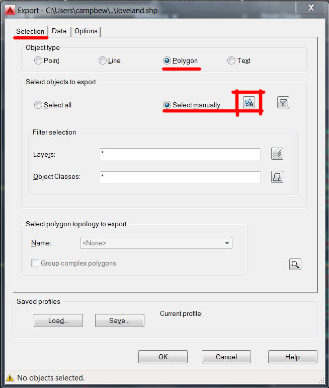

Use MAPEXPORT, select a location and name for the SHP file.
From the Selection Tab> Polygon> Select manually> use the pick box to select your closed polygon.
