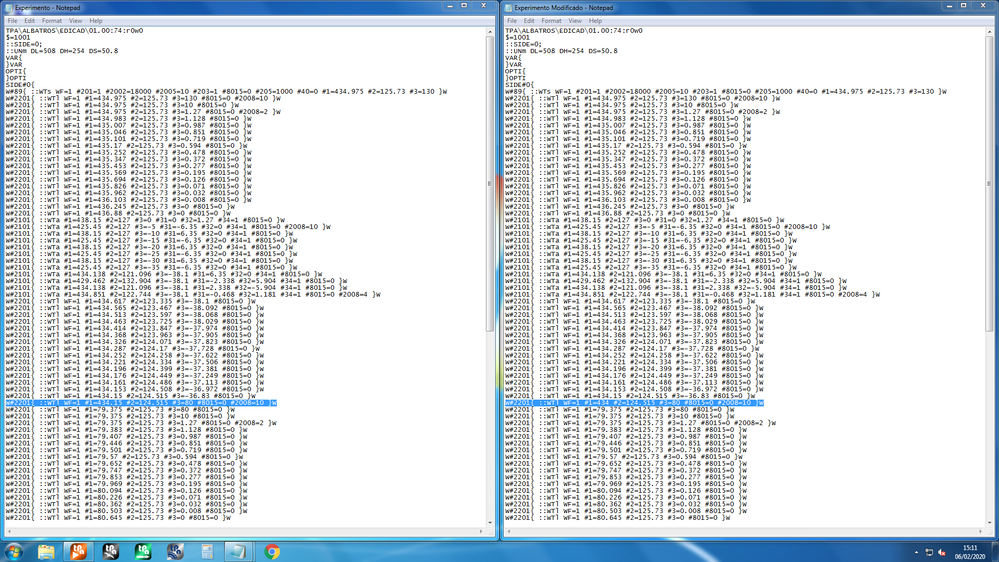

I'm getting some issues with the Felder Postprocessor. I made a very simple program with two holes and when I run it in real life I get collisions. First the tool goes down and cuts the first hole, then it is supposed to go up in Z change position in X and Y and then go back down in Z to do the second hole. In that transition I'm getting the collision. It goes directly from the final position of the 1st hole to the initial position of the 2nd hole. See video attached.
However in TPA (the software that comes with the Felder CNC) it is showing the retraction correctly.
I opened the post processed code with notepad and I manually changed the line when it does the retraction. I removed the decimals of X and that was enough to fix the problem. Please see video attached.Comparison.PNG
 It is easy to fix with this simple program but It would take me hours to fix in a complex program. I was wondering if there is a workaround for this or maybe I'm doing something wrong.
I attached the Fusion file, as well as the post processed code and the modified code here:

W#2201{ ::WTl WF=1 #1=78.55 #2=124.515 #3=130 #8015=0 #2008=10 }W

To solve the issue you modified X coordinate in a rapid movement.
Maybe you could modify your felder postprocessor to write X coordinates with no decimals in rapid movements.
If you want to do it, you could modify your postprocessor in this way.

josefloresb
Hi @andrea.amilo ,
Thank you so much, that was enough to fix the issue. The CNC is working great now.
I really appreciate such a quick response and solution.
Thanks again!
