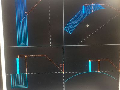

mach3 and the Gcode seems to be almost right, but the translation of the
plan when A axis moves insn't.
