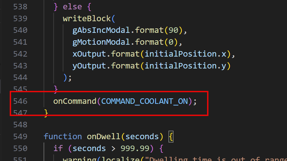

Hi
I want help to add coolant code to the attached Fagor postprocessor, it generate the machine code ok, but with out the M8 and M9 code.
I will be very happy if somebody can help me.
Kind regards
 Torben

Hello @torABLHW ,
I have noticed that the postprocessor you are using is really outdated, it looks like 2014!
I would suggest you to update it, just download the latest version from the post library.
Having said that, I have tried to modify it to suit your needs.
Please try to do what I show you below:
1.
2.
Please test it carefully and let me know.
Thanks.

torABLHW
Thanks  andrea.amilo
That works so all seems to work well now.
Best regards
Torben
