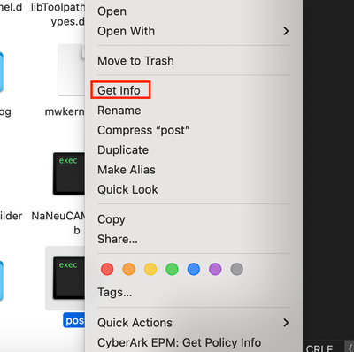

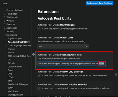

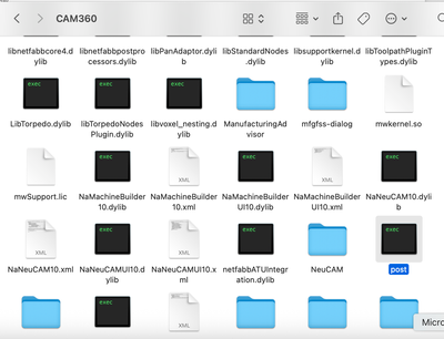

For anyone wanting to find the post utility on Mac, I have a few notes that I created when I installed it - they may help?
1) Install VSCode (download from https://code.visualstudio.com/download)
2) Once installed, on the extensions tab, Search for and Install Autodesk Fusion Post Processor Utility
3) Click on Settings (bottom of side bar) -
4) Click on ‘Extensions’ and then ‘Autodesk Post Utility’
The Post Executable Path needs to be added here –
You will need to use ‘Finder’ and browse to the following directory –
Users/Username/Library/ApplicationSupport/Autodesk/webdeploy/production/7bbcfa8bd731b98100cd66ff03f62542666d03df
The ‘Username’ is what you are logged in as, and the long number at the end of the above path is whatever version of Fusion you have installed gives you this unique folder name.
In that folder you should see ‘AutodeskFusion.app’ – this is where the post executable is.  To be able to use this, you need to open this app as a folder.  Control + Right Click on the app and then select ‘Show Package Contents’
You should then be able to browse to Contents/Libraries/Applications/CAM360/
Optionally, you can add a shortcut to the CAM360 folder to the Favourites sidebar by clicking and dragging (with the COMMAND key depressed to the desired position).  Might be useful if you need to find this again?
Control and Right Click on ‘Post’ and then ‘Get Info’
Highlight and copy (Command + C) the path beginning with users –
Paste into VS Code Settings for Post Location  (make sure ‘/post’ is on the end of the path) –
Restart VS-Code and posting should now be possible.
