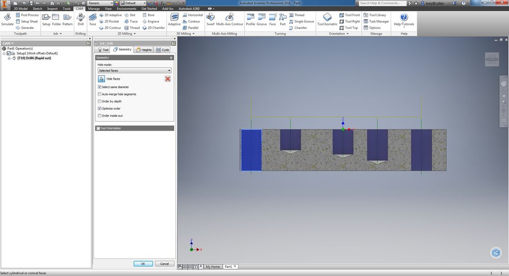

Sometimes this select same hole size check box can be more of a PITA than a good thing. Can the option be changed to "select same hole size and length"?
This allows for different hole groups to be selected instead of all holes the same size to be grouped together. You might have a part with 3/8-16 tapped holes with some tapping thru and the others are blind tapped to a depth. With the current system you are forced to select the holes individually to get the different groups for your operation. This is OK for small amount of holes, but do a couple hundred and tell me how slick "select same hole size" works for you.
On another note could this "select hole same size function" be implemented in another way for creating patterns for sub-program support? Kinda like the create profile function or spun feature for the turning side. It would create a parametric sketch that a sup-program could use for hole patterns that don't fit into the HSMworks pattern function.

@Greg_Haisley would the bottom height "hole bottom" not allow for this? if it is modeled correctly then by using the "hole bottom" and "drill tip through bottom" would this not solve that issue?
Greg_Haisley
@Anonymous you are missing the point.
It's the selection process that needs enhanced. If 2 groups of holes are lumped together you can't segregate the different groups by selecting different bottom heights. One group may have a need for the tapping to be a blind depth and the other tap thru. With the current system we can't separate the two with the "same hole size option". If length were analised by the system along with diameter, then we could get two different groups automatically with 2 mouse clicks. With the current system it takes a mouse click for each hole in my scenario.
@Greg_Haisley I think I understand what you mean, but I thought that function is fulfilled with what I mentioned above, see the pictures, I have a number of holes at different depths, all drilled to the correct depth using the "Hole Bottom" for the bottom height in the 1 cycle.
or would this only be a tapping scenario you are mentioning?
Greg_Haisley
It relates to the tapping scenario for sure. Or other situations like any function that doesn't lead to just drilling thru. Even with the drill thru like your example - if you wanted the drill to go all the way thru on the thru holes I would add some amount to the break thru parameter. You can't do that just on the drill thru holes by themselves. This is why there should be a select by hole size and length as well as the select by hole size. Both options gives the user flexibility to define a hole group the way the user wants.
