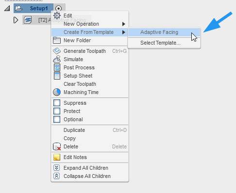

Hey guys!
It's great to see some more in depth discussion about CAM strategies! I wanted to quickly tell you guys that this is possible currently. And it's pretty simple too 🙂
Here's a quick tutorial I recently created on how to do exactly this, it's one of my favorite tricks.
Bonus Tip:
After you create this operation, you can right click -> store as template. This way you can easily reuse it on future setups.
vQZdHzW
NaqEph2
Hope that helps! Let me know what you think, and if you guys have any questions.

The only problem with using 3D adaptive in this method is you have to have flat area detection ticked, and set to a low value.  This means that the output code will match the amount of stock to leave you had input.  The point I was making about having it included in the facing strategy was to reduce calculation time, eliminate some weird artefacts you sometimes get with the 3D adaptive, and enable greater control over the multiple depths, stock to leave, and enable a finish pass (all features currently available in the dedicated facing operation).  Ideally this feature would be optional for the finish pass, having it's own "morphed spiral" tick box.  I'm not arguing there isn't a workaround, I am arguing that the workaround isn't ideal.  Even allowing completely open pockets in 2D adaptive would be better than using 3D adaptive.
@xander.luciano
I would agree with @Anonymous that we would need to be able to do this in the 2D Adaptive or in the facing strategy. (I'm for 2D Adaptive)
But not using the 3D operation.
