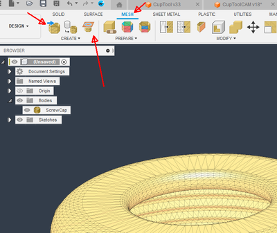

Honestly that is the worst way to work with a mesh in Fusion.
Here's a screencast I made a while ago that shows how to use Mesh Sections to create a non faceted body. This was done in an old version of Fusion but should give you an idea how it works and how easy to get a native body in Fusion.
EDIT. With  the newer version of Fusion you need to work in the mesh workspace, import the mesh then create the mesh sections.
