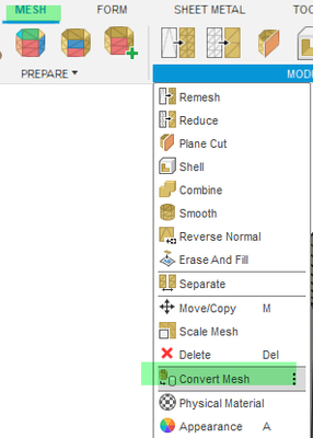

It is in the Mesh tool tab, under the Modify menu, the command is called "Convert Mesh"

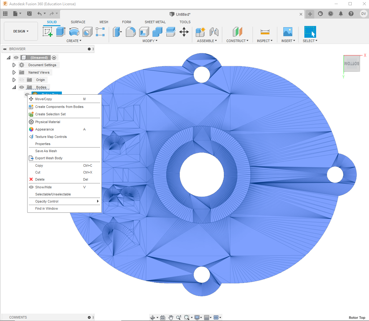

Thank you for responding, but that screen isn't what I see.  I have attached screenshots and the file I am working with.
