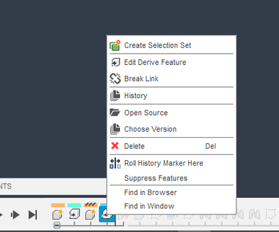

Occasionally I've had cases where I've not got a prompt to update and needed to right click the derive feature in the timeline and update from there.
