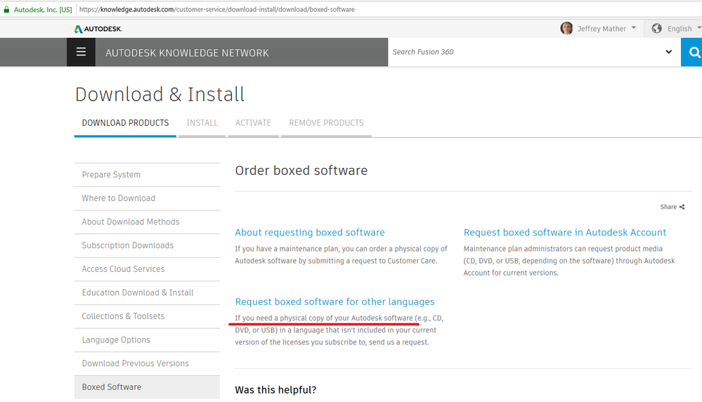

Just like having a DVD (or USB drive) shipped to you like in years past.
I just found this on the Autodesk website http:\\manage.autodesk.com
but not sure if it is still valid.
