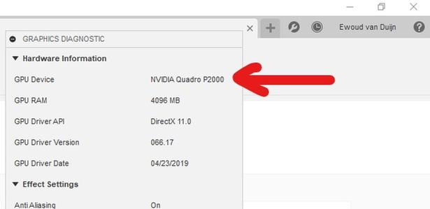

We had the same problem, turns out that using the laptop on a docking station, on startup Fusion360 automaticly switches to the Intel HD-driver instead of the Quadro. Can you check which graphics card Fusion is using?Annotation 2019-07-26 123712.jpgAnnotation 2019-07-26 123618.jpg

But as I state, this is a work around, not a solution. I checked the Graphics card in the two situations:
First connect, then start up Fusion --> Results in the Error (Quadro Card, not the Intel)
First Start up Fusion, then connect --> No Error (Quadro Card, not the Intel)
I also disabled the Intel card in the Bios, so it should never switch and the diagnostic confirm that I am in both situation on the Quadro Card, but still I got the Error.
Haven't found the Solution though
Hey Joel,
I found when I connect the laptop to the dockingstation via USB2.0 instead of USB 3.0 Fusion starts up with the correct graphics card automaticly selected. So for me this solves the problem for now.
