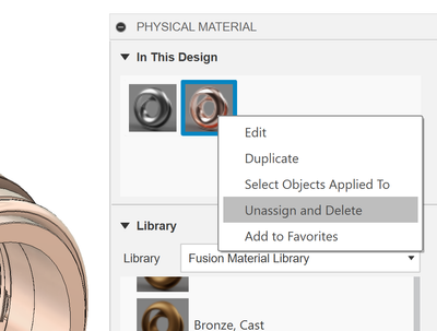

ltomuta
The STEP files I receive from customers are, for the most part, defaulting to Steel as the physical material. When I try to change it to something else, I get random results. Sometimes it works, other times it fails with the above warning because apparently in this context default means something else than "implicit selection in case nothing else is specified".
The only thing guaranteed to work: deleting part's "default" material, which gets replaced instantly with Fusion's default, which in my case is Aluminium.
I don't understand how a bug/limitation for something this basic is allowed to persist for so long in the product. Especially now that in the Manufacturing workspace they are actually taking the material into consideration for selecting e.g. feeds and speeds. So it should be easy to set the material as part of the workflow. But it is not.

test_material.f3d is a simple native Fusion design. The material applied is my configured default, Aluminium 5083.
test_material_steel.step is a version of the same file after the material was successfully changed to Steel.
When you import this step file, there is already a problem as there are two Steel materials listed where there should be one.
Say I want to change the material to Brass. Which of these materials I should drag and drop the new material onto? If I drop Brass onto the first Steel material on the list, instead of having it replaced I get Brass added to the list of materials and the warning message is displayed. The expected result is that the old material is replaced in the list with the new one and my component has only one material as only one is in fact used/needed. The warning also makes no sense from a default perspective. My default is Aluminium 5083 if anything, and there should be no trace of that material left in this imported step file.
eMG1-110-G4.stp is a random sample step file found by way of google search. There does not seem to be a material specified in it but upon opening it in Fusion "Steel" is listed as the material in use. Why Steel and not my default material? If I try to change the material by dropping e.g. Copper onto it, I get the same result: Steel remains in the list, Copper is added to the list of materials and the waring is show.
If I try to delete the added Copper, I get my default Aluminium added to the list (for no reason)

The error dialog refers to the default material, and while it looks like you may have found other bugs here, the basic message of the dialog is correct. The default material cannot be deleted in a parametric model.
There was a change to Fusion that put all imported designs into a default state that is the same as your preferred document default. People were complaining that they would open a step file and do work on it before realizing there was no timeline. At any rate, the step files you open have timelines and that interferes with deleting materials, and it always has - this is not new, and it is why that warning message exists to inform you of this.
I found a couple bugs, and you helped point them out, about how default materials get mixed up, e.g. steel vs aluminum as the default. I found the same thing when I set mine to Aluminum and tested it. I'll follow up with the materials developers to see what they can do about this.
To use whatever material you like, turn off the timeline. Here's a video about it.
