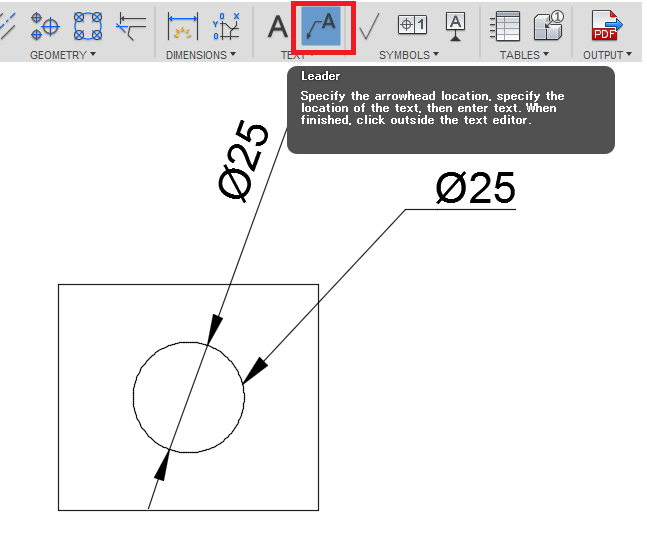

Trying to jog my dimension and after extensive Google:ing I´m not much wiser... please help me out here.
If you take a look att the attached JPG you´d see what I´m looking for.

Hi @petrol_junkie,
Thank you for posting! I'm not sure if Fusion has the ability to do that with the Dimension command but I'll check internally and  let you know as soon as I have more information.
In the meantime, could you try using the Leader command instead and manually enter the value?

Hi @petrol_junkie,
I just learnt that the diameter dimension style is based on the standard used for the drawing, ASME (leader-style) or ISO (aligned). You can’t switch between the two. The Standard will also affect other settings like projection angle, some of these can be overridden in Properties, which will apply to new drawings, not existing.
Hopefully this information helps!

petrol_junkie
Hi @masa.minohara
Thanks for your reply.
Entering values manually, for me, is strictly forbidden. Since the drawing wont update with the model. (Fusion does do that right?)
Ah ok... well that´s not really a solution since ISO and ASME uses different angles of projection, which renders the drawings pretty much useless in this part of the world.
// P-J

petrol_junkie
@Anonymous
We are still not quite on the same playing field here...
What I am trying to do, in drawing mode, is to have my diameter dimension text in a horisontal position instead of colinear with the line from the dimensioned hole.
Hence my title to this thread: Jog the dimension.
// P-J

cmiller66
Hi petrol_junkie,
The short answer is, what you're trying to do is not possible. In the drawing environment, the dimension style is based on the standard used for the drawing, ASME (which includes leader-style diameter dimensions) or ISO (aligned diameter dimensions). You can’t switch between the two or modify the style of an individual dimension.
If you create a new drawing using the ASME standard/mm units, you'll get these dimensions but you'll also get the Ansi sheet size instead of ISO.  In Preferences some of the default settings, like projection angle can be overridden, but this doesn't get into dimension styles.
Chris

petrol_junkie
Hi @cmiller66
Yeah, that was my conclusion as well....
We do use the ISO standard here in Sweden but we do deviate...
But really... theese are things that you should be able to choose while making the drawing.
The lack of options in Fusion/Drawings are significant.
Thank you for your reply.
