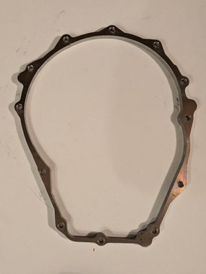

Little backstory. I build and race Prostreet motorcycles that make around 800 HP on a turbocharged motorcycle on methanol with a street tire and no wheelie bars. We drag race these bikes at over 230mph in the quarter mile so in order to go that fast, you need to design and make your own parts. We have to use OEM motors and a lot of wild parts to go that fast. We have RPM driven lockup clutches that have to be gone through after every pass. The design that I am making is for a quick access clutch cover for a new Kawasaki ZX10 with a slider clutch(another one off design). Unfortunately this is a bike that not a lot of folks make parts for, unlike the Suzuki Hayabusa which we have already made one of these for. The stock cover is made out of Magnesium and we cannot just weld the aluminum ring and cover to it so we are reverse engineering one to be machined out of aluminum.  The one we made was just an epoxied ring and cover but it is already leaking. I took a photo and lined it out in AutoCAD as I was going to just make the base ring and produce a carbon fiber mold to make this but after all of the work it was going to take I just wanted to make a full aluminum part like what is already out for the Hayabusa. You will see that I made a DWG file and water jetted the part out and it fits up perfectly. That being said, instead of redoing the file for that very weird shape, I imported it into fusion and began making the rest of the cover off of the file I made originally. I have already gone through a couple revisions and 3D printed them to make sure all of the geometry works. I am not just doing the final touches like the recessed holes that mount to the engine cases. I have 19 years of engineering and operations experience in Aerospace manufacturing but I'm not a design engineer so I'm doing this for fun and to meet a needs of a good friend. I may not know the best way to perform the design specifics in a 3D modelling software but I have a lot on 2d AutoCAD experience and manufacturing on parts. I am in the business of managing the manufacturing process of jet aircraft and rocket aerospace parts so I'm not a novice by any means. I know what I'm looking for conceptually  but the hands on design is where I'm very green. This is just a personal project and I believe for a guy that is just doing this one the side with only the help of the team on here, I think I'm doing pretty **** good lol. All in all this is a very basic design albeit with a bunch of funny draft angles.

In all of those years I do not recall seeing a flange that is not perpendicular to the clamping face and fastener holes at an angle.  Your images do not seem to support that design decision either.

You never answered my question about how you are going to manufacture the sides of the flange at an angle (same with holes)?
I understand that you want the cylinder to be at a compound angle, but the flange should be perpendicular in my experience (and from what I can tell from your images).
See my rough interpretation of what you had done so far.
I have zero confidence in the original source geometry and did not try to complete to image you show.
My advice would be to examine the Attached file and then start over natively in Fusion 360 asking questions after each and every step.
I would use multiple orthogonal images along with calipers to get started.
I must confess that I am still completely confounded by the angled base and holes - not what I have ever seen in any flange design like this.
