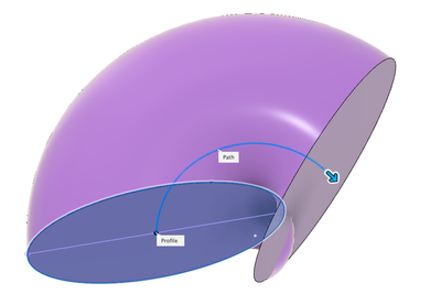

GRSnyder
@jeff_strater wrote: a solid sweep cannot self-intersect, and there is no way around that in Sweep.
@jeff_strater, is this not a self-intersecting Sweep?
Here it is as a pattern of extrusions along the same path, which shows the intersection more clearly:
I'm sure the limitation has something to do with intersecting geometry, but it must be something more specific than just "two 'stations' of the swept profile cannot claim the same point in 3D space". No?
Edit: In fact, even this self-interpenetrating result seems to be allowed :

jeff_strater
@GRSnyder - you are definitely right.  Apparently, my information was sorely outdated.  What seems to be the case is purely analytic geometry (lines and arcs) seems to allow self-intersections, but a more complex path, like a spline, does still have this restriction.  I do remember, now that you mention it, hearing about a kernel improvement a while back that would allow self-intersections in some cases.  I apologize for the misinformation...

GRSnyder
Thanks, @jeff_strater, good to know!
The case that set me on the path of investigating this does indeed involve splines, both for the profile and the rail. So it's entirely plausible that this might still be the important distinction. It's a confusing problem to run into because the error message explicitly talks about the issue being self-intersection, and yet the canonical example of a Sweep is often something like the 90 degree pipe bend shown above.
