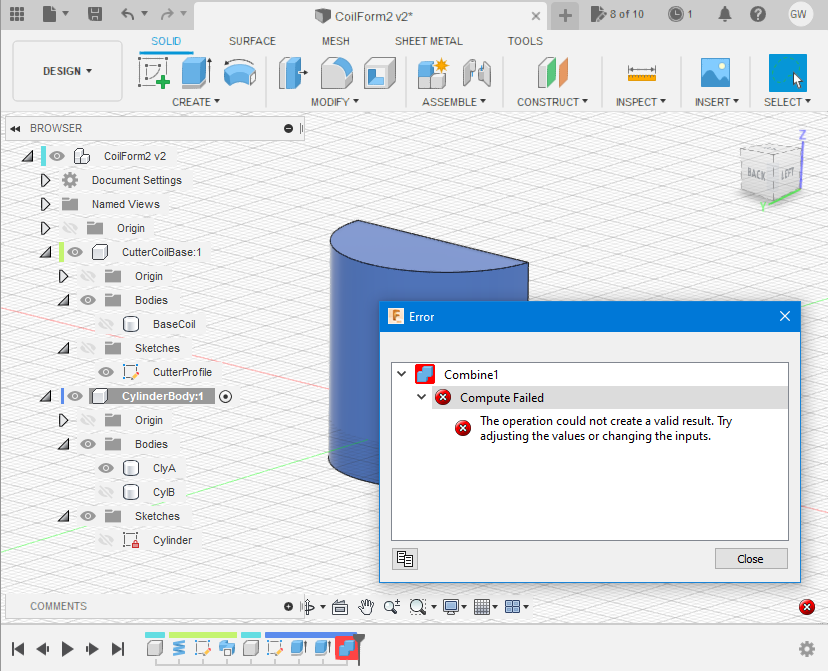

My model, which is to be a form for a wire coil, consists of a cylinder with  "custom thread" cut into it, like this:
(The cylindrical form is in two halves, to make it easier to 3D print.)
The number of turns is parametric. Seven turns works, but if I increase it to eight, Fusion throws a Compute Failed error:
Obviously, I would like to find out how to avoid this.  I thought I followed the recommended practice to do something like this, as demonstrated by Lars Christensen in "Forgot About Sweep's & Custom Threads?"  https://www.youtube.com/watch?v=WvCNGR8C2uo
Start with a triangular coil:
... and on the face of the end of the coil, make a sketch of the desired cutting profile, which is simply a rectangle with a semicircle on one side.
Then sweep that profile along the triangle edge, using a second triangle age as a guide rail:
This results in my two semi-cylinders, plus the custom-profile helix, ready for use as the cutting tool in the combine operation.
But, as shown above, if I increase the turns above eight, I get the Compute Error.  (And I actually need this to work for twenty or thirty or more turns.)
Any idea how to solve this? Have I inadvertently introduced some compute-intensive geometry?  Yet the steps are so simple it's hard to imagine that Fusion 360 can't cope with this.

@TrippyLighting   So far as I could tell, your demo showed an alternate way to create the geometry for the tool, but did not go so far as to apply the tool to combine-subtract from the cylinder.  It's at the combine-subtract that the compute error occurs.   I recreated your demo following your screencast step by step, and when I extended it with the combine-subtract, I got the compute error, as before, but at fewer turns.

sorry for the slow response, @graham.wideman.  I was on vacation last week and did not really investigate this until today, so I did not realize that the failure was in the Combine, not the Sweep itself. So, I apologize for that incorrect diagnosis.  I somewhat suspect that the problem is here:
that is the first vertical split in that surface, so the evidence is pretty circumstantial, but it is interesting that this split occurs on the 8th turn.  I'll create a bug to investigate further.  Thanks for sharing the model.

@graham.wideman - sorry for the delay.  This model is quite intriguing.  Today, when I went to look at it, even with 7 turns, on Compute All, it failed.  For a while, it would not succeed unless I went down to 4 turns.  Then, magically, it started working again, but only up to 5.  So, my theory about the surface split after turn 7, I think, was nonsense.  I think this will take some investigation by our kernel team to figure out exactly what is going on.  Very strange.

not a whole lot to add here, but I did get an acknowledgement that this looks like a bug in the kernel Boolean code, but they are just investigating it.  I would not expect a fix to be available for a while, but the core message here is:  you are not doing anything wrong in your modeling.  Not very helpful, I understand...
